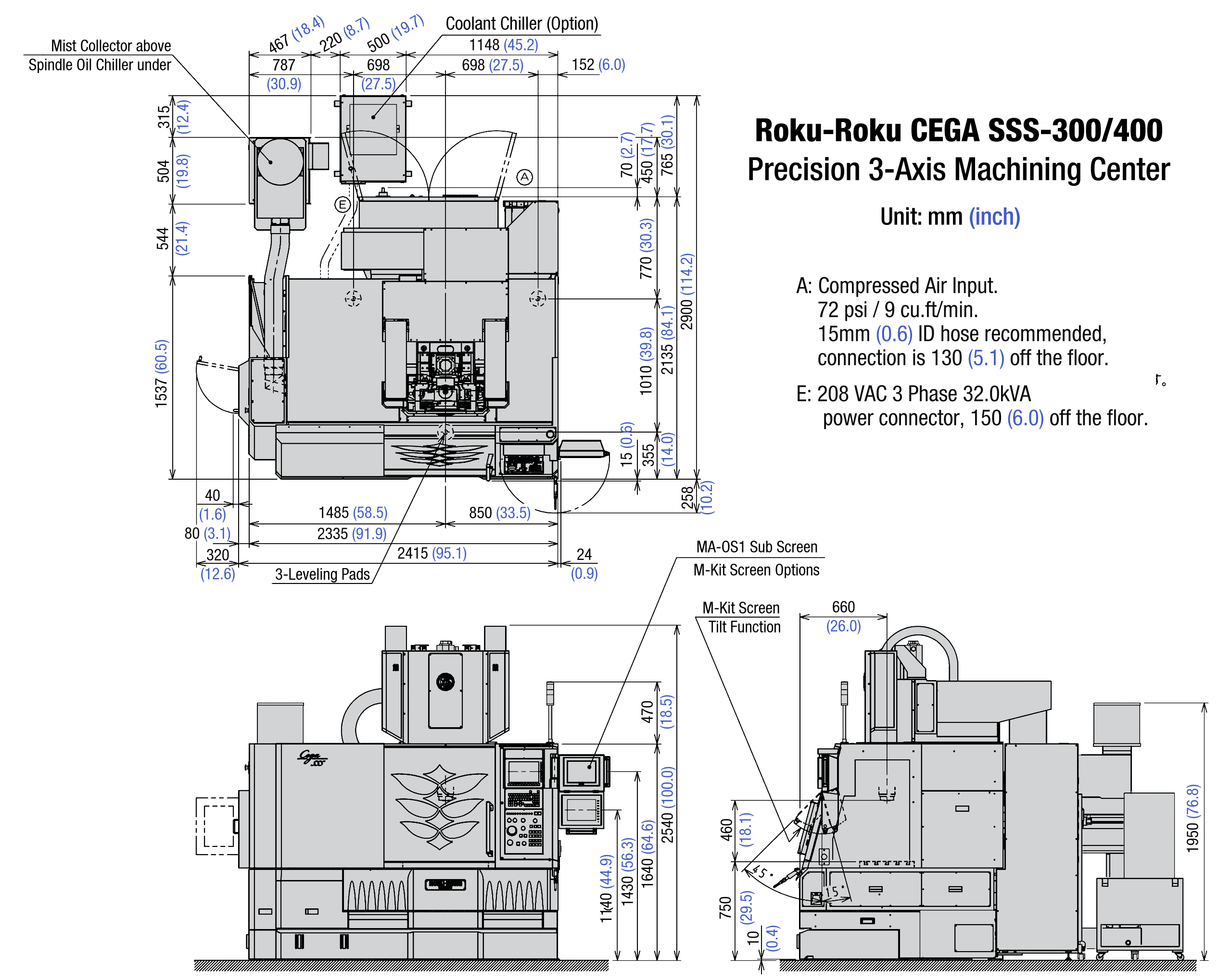

Machine Travels: X x Y x Z in (mm) 20.0 x 16.0 x 12.0 (510 x 410 x 310)
Spindle Speed: SSS 300 (SSS 400) 200 ~ 30,000 RPM (200 ~ 40,000 RPM)
Spindle HP: SSS 300 (SSS 400) 20 (7.4)
Spindle Lubrication Oil Mist
Tool Changer Size 20 Position Standard
Positioning Accuracy/Repeatability: in (μm) ±0.000040/±0.000020 (±1.0/±0.5)
Table Work Area X x Y: in (mm) 25.5 x 16.0 (650 x 410)
Table to Spindle Nose Distance: in (mm) 5.9 ~ 18.1 (150 ~ 460)
Max. Workpiece Weight: lb (kg) 440 (200)
Coolant Tank Capacity: gal (L) 52.8 (200)
Table Height from Floor: in (mm) 29.5 (750)
Actual Measured Circularity (2.0″ dia. @8 IPM): in (μm) 0.000044 (1.1)
Spindle Taper HSK-E40
Spindle Air Purge Standard
Air Blast through Spindle NA
Oil Mist with Collector Standard
Linear Scales X, Y, Z – axes Heidenhain 0.000002mm Standard
Rapid Traverse Speed: in/min. (m/min.) 590 (15.0)
Cutting Speed (Normal Mode): in/min. (mm/min.) 0.04 – 394 (1 ~ 10,000)
Cutting Speed (GR Super PC Mode): in/min. (m/min.) 590 (15.0)
Dust Collection System NA
Machine Weight: lb (kg) 11,464 (5200)
Machine Height: in (mm) 100 (2540)
Required Floor Space [Machine Unit]: in (mm) 95.0 x 114.0 (2410 x 2895)
Control Unit Fanuc 31i-B5 Super High-Speed Processor and Al Contour Control II
Power Requirements KVA 200 ~ 220V 32.0KVA
Air Supply 17.5 cu.ft./min @ 72 psi (0.5 MPa @ 400NL/min.)
