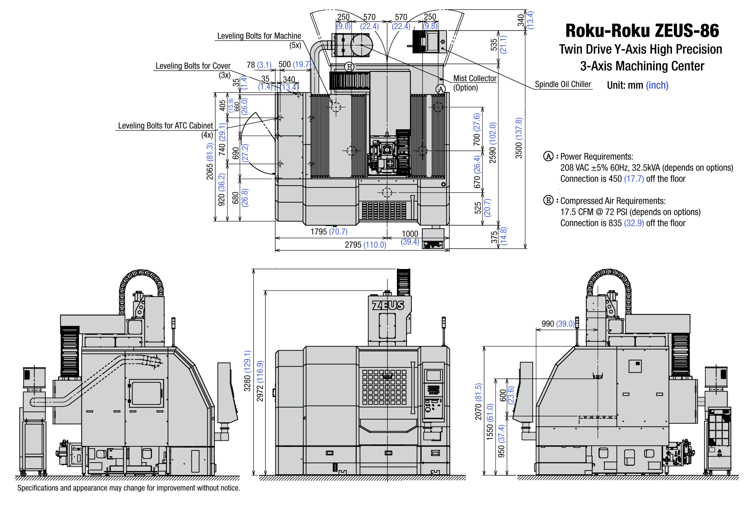

Machine Travels: X x Y x Z in (mm) 31.5 x 23.6 x 15.7 (800x 600 x 400)
Spindle Speed 200 ~ 25,000 RPM
Spindle HP (kW) 20 (15)
Spindle Lubrication Oil Mist
Tool Changer Size 30 Position Standard(60 Tools Optional)
Positioning Accuracy/Repeatability: in (μm) ±0.000080/±0.000030(±2.0/±0.8)
Table Work Area X x Y: in (mm) 37.4 x 23.6 (950 x 600)
Table to Spindle Nose Distance: in (mm) 7.8 ~ 23.6 (200 ~600)
Max. Workpiece Weight: lb (kg) 1,763 (800)
Coolant Tank Capacity: gal (L) 62.5 (237)
Table Height from Floor: in (mm) 37.4 (950)
Actual Measured Circularity (2.0″ dia.@8 IPM): in (μm) 0.000078 (2.0)
Spindle Taper HSK-E50
Spindle Air Purge Standard
Air Blast through Spindle Standard
Oil Mist with Collector Optional
Linear Scales X, Y, Z – axes Heidenhain 0.00001mmStandard
Rapid Traverse Speed: in/min. (m/min.) 787 (20)
Cutting Speed (Normal Mode): in/min.(mm/min.) 0.01 – 315 (0.25 ~8000)
Cutting Speed (GR Super PC Mode): in/min. (m/min.) 590 (15)
Dust Collection System NA
Machine Weight: lb (kg) 17,640 (8000)
Machine Height: in (mm) 129 (3276)
Required Floor Space [Machine Unit]: in (mm) 110.2 x 153.5 (2800 x3900) includes rear clearance
Control Unit Fanuc 31i-B5 Super High-SpeedProcessor and Al Contour Control II
Power Requirements kVA 208VAC ± 5% 32.5kVA (depends on options)
Air Supply 17.5 CFM @ 72PSI (depends on options)
