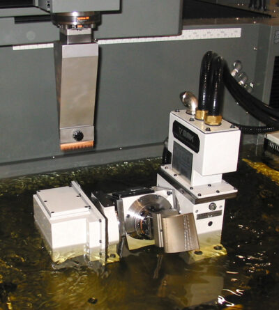

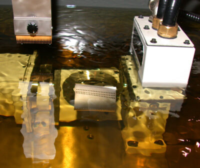

Sinker EDM uses a shaped electrode (usually made of graphite or copper) that is precisely machined to match the desired geometry. This electrode is then plunged into the workpiece to erode material and create complex shapes.
Sinker EDM excels at creating deep cavities, pockets and internal geometries that would be difficult or impossible to achieve with traditional machining methods. This capability is essential for producing components like turbine blades, fuel system parts and structural elements with intricate internal features.
Additionally, sinker EDM is often used to produce precision tooling for aerospace manufacturing, including dies, molds and fixtures. These tools must meet exact specifications to ensure that the parts they produce are consistent and reliable. The process is also used to create complex fixture components that hold parts in place during other machining operations, ensuring that the parts remain perfectly aligned and that the final assembly meets the required tolerances.

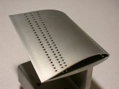

Turbine blades: EDM is used to machine cooling holes in turbine blades, which are often made from nickel-based superalloys. These cooling holes are critical for maintaining blade integrity under high-temperature conditions.
