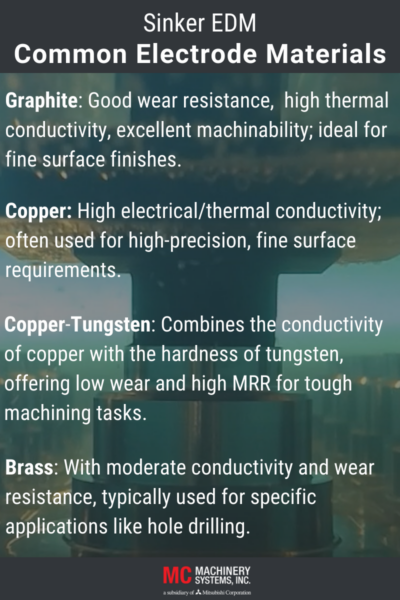

Commonly Used Electrode Materials
In the North American market, graphite is the standard electrode material for EDM applications. Graphite electrodes, which enable faster roughing cycle times and cost less than other materials, are often used for steels, aluminum, Inconel and Titanium.
The use of copper as an electrode material is also quite common, but its prevalence depends on the specific application and industry. Copper is often chosen when a very fine finish is required or when machining high-precision details. It is also frequently used when working with less conductive materials. Copper is more expensive than graphite, making it cost-prohibitive for high-volume production. Unlike graphite electrodes, copper electrodes don’t produce dust during machining, making copper the preferred choice in environments where air quality is a concern.
Copper tungsten electrodes are often used for machining hard materials like carbide, stainless steel and other exotic alloys. The combination of copper’s conductivity and tungsten’s durability makes copper tungsten electrodes a preferred choice in sinker EDM for applications that require fine tolerances, precision and durability.
