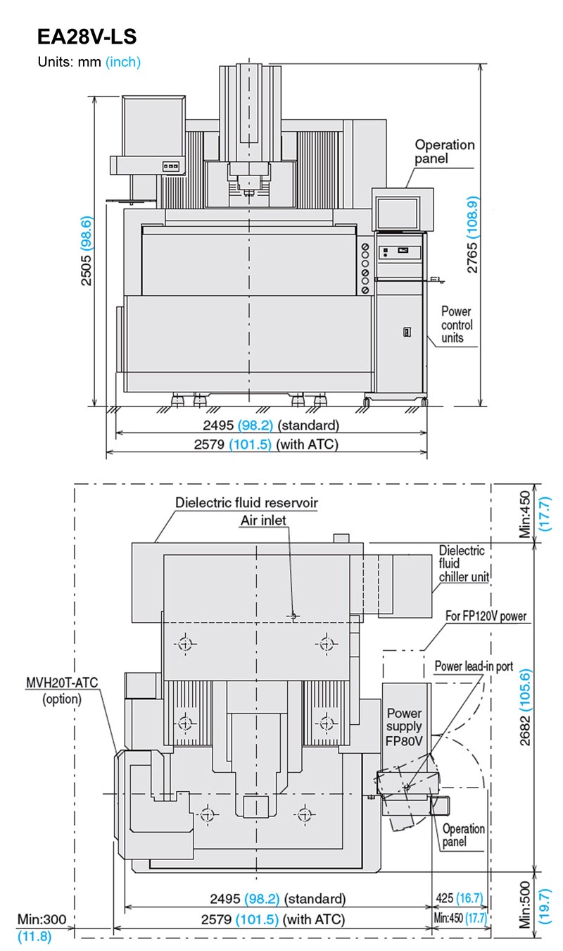

Machine Travels X x Y x Z: in (mm) | 39.4 x 18.5 x 17.7 (1,000 x 470 x 450) |
Maximum Workpiece Size W x D x H: in (mm) | 53.1 x 33.5 x 17.7 (1,350 x 850 x 450) |
Max Dielectric Fluid Level: in (mm) | 5.9 ~ 19.7 (150 ~ 500) |
Power Supply (Option) / Peak Current | FP80V / 80 AMPs (FP120V / 120 AMPs) |
Internal Worktank Dimensions W x D x H: in (mm) | 55.1 x 35.4 x 21.7 (1,400 x 900 x 550) |
Worktank / Door Type | 3-Sided Drop Tank |
Max. Workpiece Weight: lb (kg) | 4,409 (2,000) |
Table Dimensions W x D: in (mm) | 43.3 x 29.5 (1,100 x 750) |
Max. Electrode Weight: lb (kg) | 441 (200) |
Table to Platen Distance Min ~ Max: in (mm) | 22.6 ~ 40.3 (575 ~ 1025) |
Table to C-Axis Chuck Distance Min ~ Max: in (mm) | 18.4 ~ 36.1 (467 ~ 918) EROWA ITS Chuck |
Table to C-Axis Chuck Distance Min ~ Max: in (mm) | 17.7 ~ 35.4 (450 ~ 900) 3R MACRO Chuck |
Minimum Command Unit / Resolution: in (mm) | .00001 / .000002 (.0001 / .00005) |
Rapid Travel Speed: in/min. (mm/min.) | 78.7 (2) |
High-Speed Jump Maximum: in/min. (m/min.)[G] | 590 (15)[0.6] |
Filters / Type | 3 pc. / Paper Cartridge |
Filter Tank Capacity: gal (L) | 283 (1,070) |
Machine System Dimensions W x D: in (mm) | 98.2 x 112.2 (2,495 x 2,850) |
Machine Installed Height: in (mm) | 112.8 (2,865) |
Machine System Weight: lb (kg) | 13,118 (5,950) |
C-Axis Min. Indexing Angle / Drive Unit | .001º / .001º |
C-Axis RPM Range | 1 ~ 30 |
Fluid Temp. Control | Chiller Standard |
Automatic Tool Changer Options | LS-10, LS-20, MVH-20, MVH-40 |
Power Requirements [KVA] | 200/220 VAC ±5% [14 w FP80S, 16.5 w FP120S] |
Compressed Air Requirements | 2.7 cu.ft./min @ 90-100 psi |
