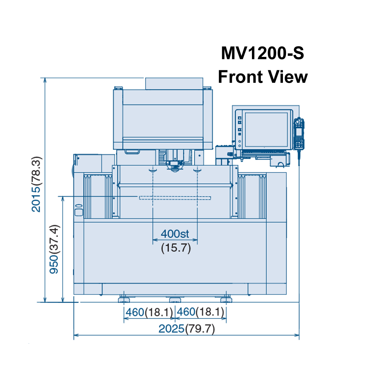

Machine Travels: X x Y x Z in (mm) 15.7 x 11.8 x 8.7 (400 x 300 x 220)
Maximum Workpiece Dimensions: W x D x H in (mm) 31.9 x 27.6 x 8.5 (810 x 700 x 215)
Max. Submerged Workpiece Weight: lb (kg) 1102 (500)

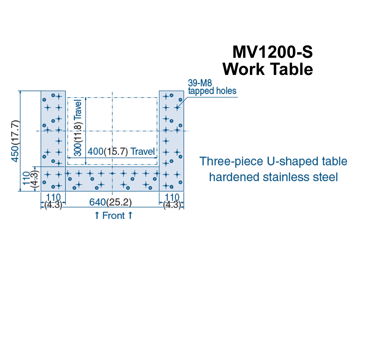

Table Dimensions: in (mm) 25.2 x 17.7 (640 x 450)
U/V Travels (from center): in (mm) ±2.4 x ±2.4 (±60 x ±60)
Taper Angle @ Thickness: in (mm) 15 deg.@ 8.0 (15 deg.@ 200)
Wide Angle Taper (Optional Guides Required) 45 deg. @ 1.8″ 45mm (No AT Possible)
Table Rapid Feed Speed: in/min (mm/min) 51.2 (1300)
Power Supply V350-V
Minimum Drive Unit / Resolution 0.000002 / 2 µin ( 0.00005 / 50nm)
User Program Storage [Hard Disk Size] 1 GB [32 GB CFAST Card Size]
Wire Diameter Possible: in (mm) 0.004~0.012 (0.1~0.3)
Minimum Start Hole Diameter: in (mm) 0.02 (0.5)
Max. Wire Spool size On Machine / Cabinet STD: lb (kg) 22 / 44 (10 / 20)
Filters / Type 2 / Paper
Filter Tank Capacity: gal (L) 145 (550)

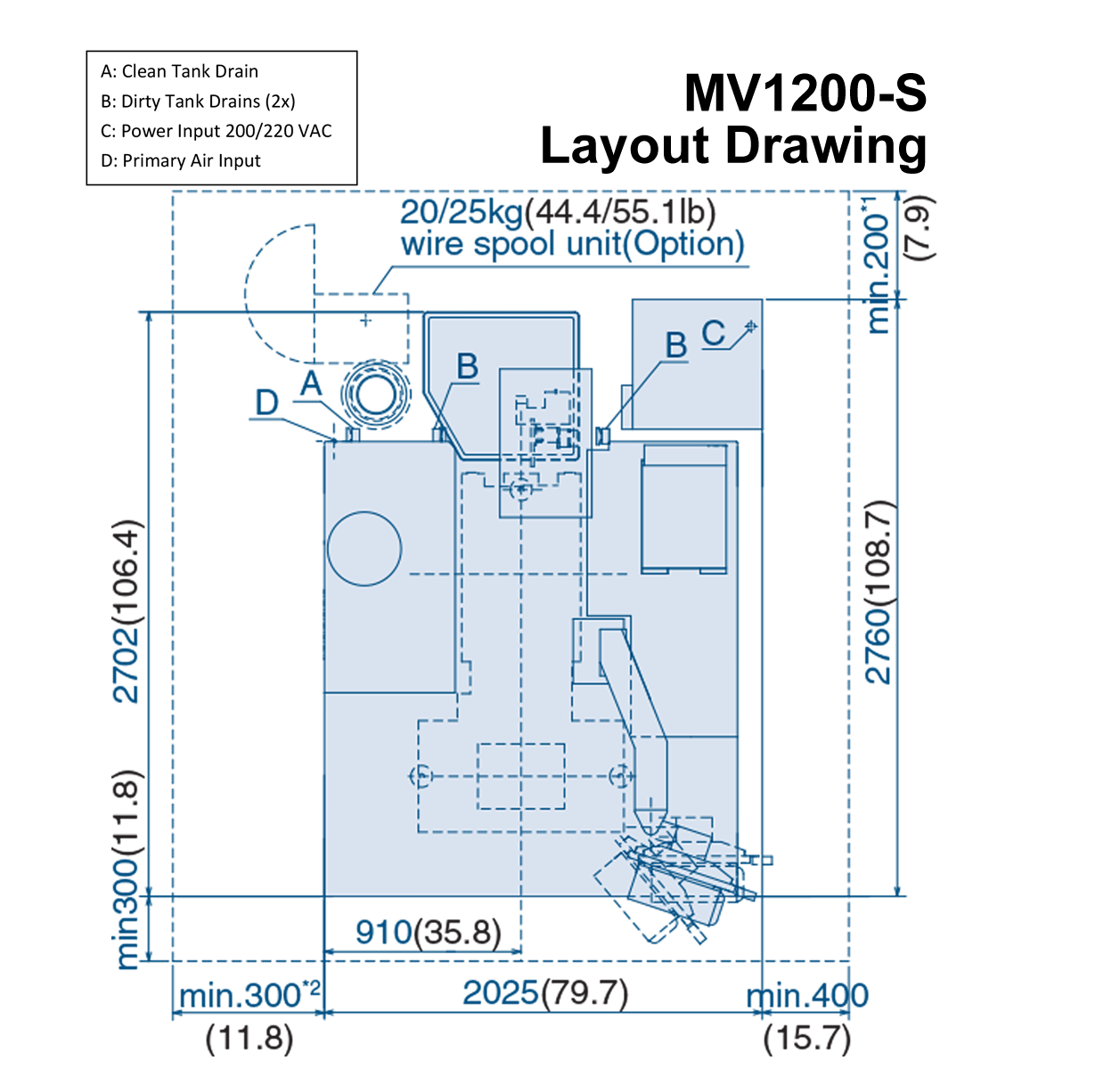

Machine System Dimensions: in (mm) 79.7 x 106.4 (2025 x 2702)
Machine Installed Height: in (mm) 79.3 (2015)
Machine System Weight: lb (kg) 5952 (2700)
Fluid System Weight: lb (kg) Included with machine
Power Requirements [KVA] 200-230V [13.5] Built in AVR
Compressed Air Requirements 2.7 cu.ft./min. @ 71~100 psi
